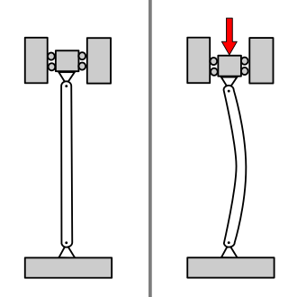

    Dire que "ça ne change rien" revient à assimiler résistance d'une fibre de carbone à son étirement et sa résistance à la compression (menant au phénomène dit de "flambage", buckling en anglais). Assimiler explosion et implosion également. Ca m'étonne de toi !
    Nom : flexion.png
Affichages : 157
Taille : 9,7 Ko
    Voici ce qu'en dit Roberto Ballarini (Research lead and professor of civil and environmental engineering) dans cet article
    https://www.newsweek.com/titan-subme...ckling-1896205
    "The material used for the Titan's hull was a carbon fiber composite. It is well known that under compression loading the fibers in such composites are susceptible to micro-buckling and that they may delaminate from the matrix that surrounds them.
    "If the Titan's hull experienced such damage under the extreme compressive pressures it experienced during its dives, then its stiffness and strength would have significantly decreased, and together with the inevitable geometric imperfections introduced during its manufacturing, may have contributed to its buckling-induced implosion."
